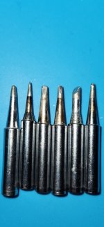

Tip pic incoming....
In looking at them, yeah, they look super burned and in terrible shape. I should add that as I was working with them, and noting that it was getting harder and harder to keep them clean, get the solder to melt, I would try to switch out tips. I was trying all of the usual methods to clean them- slightly damp sponge, brass wool, re-tin with solder wire basically between each component, I even tried using tip tinner. I tried keeping them clean, turning off the iron between components to try to reduce the wear on the tips. I ultimately had the most luck with the smaller chisel tip- as some folks recommended earlier.
You can see there is some solder that literally just melted and then cooled on some of the tips (see the Right-most, and middle-left tips)... so yeah, these tips are not transferring heat. These tips look like this after the aforementioned heat, plus only fully filling out one Mahayana (I havent tested it yet**), plus the few resistors on that second board. So really, minimal work to get to that condition. This still gets back to the initial trouble- even brand new, it still took significant heat to get the wire to melt - nothing in the 700's F would even get it to melt directly to the iron- which again is wild given the wire's specs.

Those tips look fine to me, and the solder joints look OK as well. It may be a problem with the station <-> tip connection? FWIW 0.8mm is the thickest I'd use on a PCB. 0.5mm melts and flows a little bit faster, I think. Those are very personal considerations, like soldering temperature itself. But it seems like the station isn't heating the tips the way it thinks it is.
Honestly, those tips don't look too bad and it sounds like you're keeping them clean. It's possible that they're garbage tier and the tinning isn't taking. You might be keeping them _too_ clean - you want a little bit of melted solder on the tip, the melted solder helps to melt other solder. If you're super meticulous about getting every bit of solder off between joints, it could be counterproductive. Also this has gotta be taking you like hours with all of the swapping out tips since I imagine you have to wait for the whole thing to cool.
