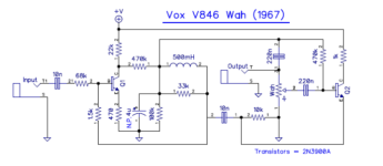

Thanks for the Clean & Clear schematic shot. Adding it to my collection...
And Big Monk's rendition:
Layout from FSB, I forget who specifically:
GOTA has a parts list floating around the forum for turning the PPCB ShamWah into an 846:
Hopefully this may be of some interest to you or benefit someone else.

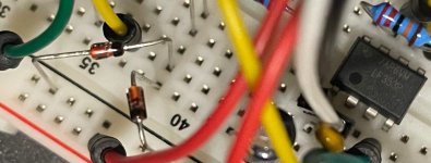

i have lost the plot.
somehow got lucky and had it running with minimal trouble.
there was no need to do this, but i guess it saves tampering with my original unit for some mod expeditions…
...no mods yet.
but tonight i captured a baseline demo of the stock circuit (+/- an SD-1 cos it’s good)
breadboarded with LF353 & TL072 opamps, J201 input buffer. (output buffer skipped, with A100K output volume pot - per GCI MT-2 schematic - otherwise completely stock per Boss schematic, with 1N4148 clipping diode pair)

update:
i’m a doofus and misplaced the clipping diodes when i was trying out red leds (not much difference), so that whole demo was opamp distortion.
there, a mod - no clipping diodes.
with the gain set at 10o’clock, it doesn’t really sound that different on a glance, but on closer inspection, it does affect the EQ (limited), overall less scooped, it’s louder, the distortion is a bit looser, it’s less smooth, and the crunch has a unique character you don’t get with 4148 clipping diodes.
i’d say it’s worth exploring as a mod.
