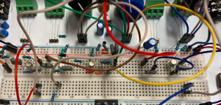

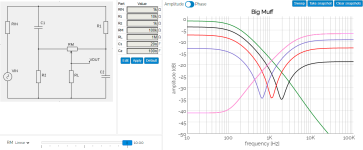

Here's another ONE from BuddytheReow. I was inspired to give myself another constraint last night when fooling around on my breadboard. I wanted to make a circuit where every component has the number ONE in it somewhere, whether it be a value or part number. Coincidentally I just won ONE of @fig 's contests so this seems fitting here. This is another dirt pedal and is in the heavy gain territory. So much gain that it's a little on the noisy side (think white noise here.) The tone control alters some of that. Speaking of tone control I wanted to see graphically what it's doing so I put this into TSC and came up with this. HUGE mid scoop on it. I did use (2) 10n caps in parallel to satisfy my constraint here. The only comment I should make on the schematic is that you should place the diode in place of R9.

Interesting, but you have the wrong value for RL in TSC. Should be more like 9K. Is R3 really 10K?

Yep. R3 is 10k. Double checked the breadboard pic. It is the second horizontal one from the left.
I still don't understand load resistances yet. Could you give me the quick and dirty?
OMG even deeper scoops
Not deeper, just more overall loss. The notch depth is the difference between the bottom of the notch and the flat parts below 100Hz and above 10KHz.
Oh, yeah, you have C1 & C2 swapped in TSC. I refer you to Bill's Law. If your breadboard matches your schematic, then there's not much mid scoop at all.

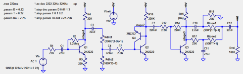

RL in TSC refers to whatever comes after the TONE pot. There's no place for C12 in TSC, so we'll ignore C12 and pretend it's jumpered. RL is then R19 in parallel with R20 in parallel with Q4's input impedance. For a first-order approximation, Q4's input impedance is R22 times HFE. Let's say HFE = 200, so Q4's input impedance is 200K. 10K, 100K and 200K, all in parallel = 8.7K. So that's RL in TSC.
I already have your other entries simulated in LTSpice, so it won't take much to sim this one.

In observance of Groundhog Day, here's my Deuce-Deuce Fuzz. Only simulated so far, so I can't vouch for its tone. Inspired by BtR's Numero Uno. I had to take liberties with the pots since we don't have 220K pots here in the States. Might work better powered by a 22V battery. ;)
