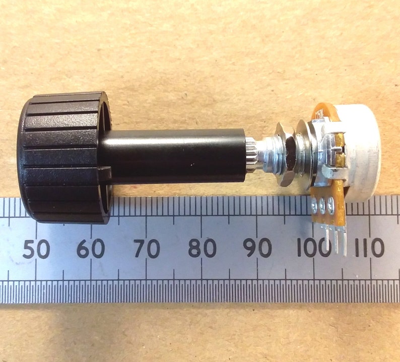

Does anyone know where I can find this style of knobs? They're for pots that sit fully inside the gear (shaft does not stick out). Used on some mixers. I have a few, don't remember where they came from. I Googled all the way to the last page of the Internet...

...But it's not the right type of knob for me. What I'm looking for is designed for pots located entirely under the surface of the panel -- not screwed on to the panel. The knob needs to have an extension that goes through the panel and into the piece of gear. Similar to this Mackie mixer knob:
Would just a regular potentiometer shaft extender let you do this with other knobs? I've seen some made of plastic and some super heavy duty ones before. I'm a knob nerd and feel like I've seen some like this before but can't find any right now for the life of me.
I tracked down some, but they're for D shafts, and mine's knurled. Looks like I might have to consider a 3D printer. Or cannibalizing some old mixer.
Might these work?
Etsy has some different types:
I also ran into these. Promising, but the knob part is too large for where it needs to go. They should be as skinny as possible.
Looks like 3d printing is the easiest way to go. I'd print only the extension shaft and take existing knob.

I picked up a few in my last Synthcube bulk-order, just to see what they're like — a couple orange and a few grey.
Alrighty then, let me just grab 'm and see ...
First of all, I thought they'd be rubbery, they are HARD plastic.
I tried to put the orange ones on the 16mm pots and grey on the 9mm trimmers for contrast:
- They do NOT fit a 6.35mm shaft diameter (whether the 16mm pots in the above pic or 9mm pots); you'd crack the plastic knob if you forced it.
- They DO fit a 6mm shaft diameter as shown above with the 9mm trimmers.
I didn't press the micro-knob all the way on the trimmer as it's a tight fit and would be a pain to get it off again, but I did lay the knobs next to the shafts so you can see they don't really extend the length much even if you put them on partially (and through usage you may end up pushing them on further and further until they're almost entirely inside the enclosure.
I'll definitely be ordering some more of them for a few projects I have, whenever SynthBear has another sale and I need some other stuff.
They're perfect for the right application, alas I don't think your project-needs suit, JTEX.
Sorry, these are not the pot-extender knobs you were looking for.
Move along...

Now that you have them out, could you please measure their length? Does the hole go all the way inside, or does it stop short of the top?
In my project, the knob only need to stick a little bit out of the side of the pedal, just enough to be able to turn it (and get a grip on it to pull it out if I want to be able to disassemble the pedal...). It's for the phones volume, sitting next to a 3.5mm jack. Looks like I'll have to re-locate the pot so the shaft end is as close to the edge of the PCB as possible, since these knobs are quite a bit shorter than what I'm using on the prototype.
