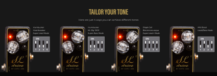

I've always had a love/hate thing going on with the Xotic mini pedals. They all sound really good, they're all a royal pain in the rear to access all the dip switch options.
The SL Drive may be the worst offender because there are so many good sounds in that little pedal but you have to take the back off to get at them.
When @PedalPCB released this board with all the dips exposed as toggles it was a no brainer for me.

Lots of Marshall sounds in this box. Everything from Plexi to JCM800. Tons of gain on tap. I am assuming that the 4 toggles map to the 4 dip switch settings on the Xotic pedal (@PedalPCB can you confirm?)
Only messed with it a little bit on my Tele Thinline but I like the "Mid Boost" setting with the gain dialed down to about 8-9 o'clock. I can get a nice cranked Plexi-ish sound on my Tele. I recorded a very short clip in this setting for some flavor.
