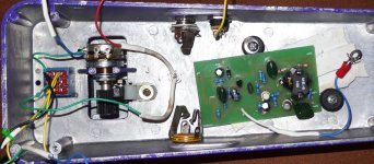

So last year I purchased a torn down BIY Wah pedal form a guy off Ebay all in a bundle of wires spliced together with shrink tubing of various colors and sizes, had two black plastic stereo jacks I removed (I have new switch crafts ready).
Now I have seen what the inside of a Wah pedal should look like have a half dozen already from Vintage Vox, Thomas Crybaby, Joe Gagen and Area 51 so on..
This pedal was all FUBAR inside, more wires than necessary going places they shouldn't be going to.
Don't know what the guy was going for but I see why I got it cheap..
I cleared all the spliced together shrink tubed Spaghetti mess off the board and now I need to know how to properly wire her back to life.
Tried to find the maker of the PCB but it has no name and couldn't find one photo of a full built board without all the wires on a socket to board layout..
The board does have marking for connection points, but since I'm not good at reading schematics I'm sort of lost!
I know this isn't Rocket Science building a standard Wah pedal, just would like to give this a voice.
Please see attached photos and if you can point out what goes where..

With little to no information about what the board is in this pedal, it's going to tough to say for certain. I don't like making guesses and posting them for others to see, but here's a very crude wiring diagram (I spent less than 5 minutes on this) of where I'd start based on information here on the forums and on other wah projects:
Of course, wiring will not rule out the possibility that the board you have simply doesn't work. I hope this helps and make absolutely no promises that my wiring diagram is correct. Input jack is shown on left, output jack is on the right. All grounds (grd as marked on board) should be tied to a common conductor or solder point.

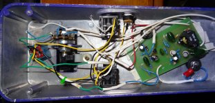

So wired it all up and nothing it will pass a dry signal when off but no power lights it up.
I'm thinking it maybe the foot switch as it looked a little cooked from whoever soldered it before or the 9v jack.
Time to break out the Fluke, any suggestions on where to probe first?
Let me know if you need more, wiring is a bit of a mess once I get it working I will tie it up.
Touched up a few sorry looking solder joints that fired up the LED but still no effect signal.
Read attachment W8 I think I found a major problem, wired the switch to one of the positive terminals of the power jack and not negative.

I'm still reviewing your wiring, but right out of the gate, the potentiometer wiring isn't the same as the diagram. You are tapped on pin 3 of the potentiometer, not pin 1. I'll edit this post as I find anything else.
Edit 1: It looks like your wah potentiometer is just wired backwards altogether. Swap wires on outer pins. Pin 3 is where the orange wires are now, pin 1 is where your blue wire is.
Where is your LED? It's difficult to help in circumstances where wire is cut in places, heat shrink applied, then changes colors at the other side.
Can you get a voltmeter out and measure voltages on each pin of the switch please? Measure each pin with the pedal in bypassed state. Then measure each pin when the pedal is in active state.
The way it looked I assumed your Diagram was showing the back side of the potentiometer.
The LED wiring see attachment..
As far as the 9v input jack the attached photo am I seeing this pin layout correctly or is it backwards?
Thanks for helping me..
