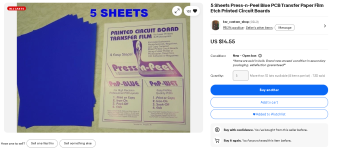

People who use transfer paper with laser printers: Please help!
I cannot figure out what i'm doing wrong here.
first of all, im using blue press n peel paper from ebay:
My first two pedals came out fine, it took 2 or 3 attempts each but had 2-3 pretty large blobs where it didnt stick. aside from that, they were fine. for these, i used a cheap iron i got from amazon which had a relatively flat plate but all of them have a 30 second shutoff, so i couldnt set it down flat for any real amount of time, i had to immediately and constantly slide the iron around and hope not to smear anything. I could never get it perfect but the results were actually better than what im getting ever since

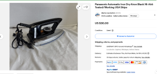

i have considered this. yesterday i did find a model that doesn't have auto shutoff. its japanese but the plate looks pretty small. so i was skeptical. but would a better iron really be better than a heavier flatter heating plate with precise temperature and completely even temp distribution across the plate?
i cant really slide it around, so maybe the iron is best in that case.

it just never turned out perfect like his examples and i didnt know why. he uses different paper than me though. is my blue paper worse than this yellow stuff or the glossy photo paper everyone seems to use? i cant figure out which glossy paper is best, but it really seems like a worse process than this. although if it sticks better, i'd definitely try it. i just need to know which kind to buy:

• I could never get Press-n-Peel to work for me. So I always used glossy (thick) magazine paper, a little harder to come by these days but those incessant alumni magazines are good for something it turns out ;)
• My heat source is an old Black and Decker ‘travel iron’ (the handle folds down for convenient storage!) that I found at the thrift store. No auto shut off.
I put it on the highest setting, stationary with pressure for 1 minute, then moving around for another 3-4 minutes.

this is great, extremely helpful. thank you. just bought this. just hoping the smudges on the plate arent flakes and wear. amazon has them but this arrives faster and i am becoming impatient. if i like it, i can order a new one from amazon later. doesnt have auto shutoff and i really like that it has no holes and entirely flat surface, no grooves or anything
