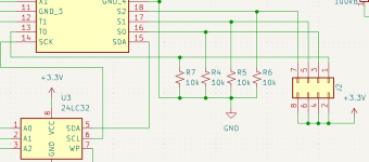

In order to embed reverb into a combo pedal, I've made a PCB in small format. My intent is to install an always-on reverb into a combo pedal and use trim pots to "set it and forget it." Here's one with alpha pots used for testing. It's almost identical to the Pythagoras with some minor exceptions. The LED is hooked to the clipping indicator from the FV-1. The output capacitor is increased to 2.2uf as I was getting some low end loss. I used SMD chips since I had to solder the FV-1 anyway. Easy to do on a hot plate with some solder paste on the pads.
Eeprom and jumpers on the back for easy access. (I know the flux needs some clean up.)

Had to make some tweaks to mine for signal levels. The clipping LED was on all the time, so signal was too hot into the FV-1. And then the signal out of the FV1 was hot and hard to only add a small amount of reverb. These changes might be needed for others. First get input signal adjusted to avoid hard clipping. Then further reduce output signal if it's still too hot to mix into the output signal.

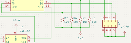

I just found this little coded rotary switch on mouser and ordered some. Also tweaked my PCB design to use it and need an excuse to order a batch. Is anyone interested? I've already built enough of the original boards that I don't need them with a rotary. But, it's so cheap to order 10...
UPDATE: I must have a serious problem... Ordered 10 PCBs from PCBWay... And 10 more FV1. I need counseling. :)
Another UPDATE. The correct rotary for pythagoras is this one (the "real code" version) but I ordered the "complementary code" version above. So, mine are going to have the numbering reversed. 0 will be 7, 1 will be 6, etc... Duh.
