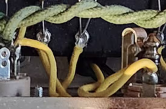

Nothing jumps out at me. Wiring looks right, no cold joints. The only things I can’t tell are if the center lug and the lug with the 500pf cap are touching. Also can’t see any under board wiring.
Assuming that’s good, the things I’d check for- does the oscillation change with knob position? Does it change when you move wires around (use a chopstick!)?
In other words- lead dress.
Next tap tubes- could be microphonic tube or even microphonic capacitor. Again. Chopstick taps.
Second question is around the NFB coming off the 4ohm tap and not 8. Shouldn’t matter
Finally lift one end of the NFB resistor to eliminate if it’s a phasing issue with the transformer. Never heard of it on single ended but I learn every day.
It's a long shot, but the cathode wire and output wire are touching, which could mean a bit of capacitive coupling.
temp-Image9t-Px4-U.avif
And those wires are running parallel, all wires are supposed to intersect as close to a 180 degree angle as possible, which is why you see curly-que wire dressing on old fenders. High voltage will just induct into the next wire if they are close and parallel.....
