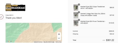

No particular reason other than the one I have has Mercury Magnetics, and I wanted to compare with Dagnal-ish transformers from Heyboer. This place had some pretty good prices.....
And I decided I wanted to redo the layout a bit differently as well....... The PT is a stand-up, so I don't have to plan around that big-o hole in the chassis. I have a little more to do to finish this off.

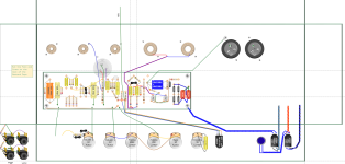

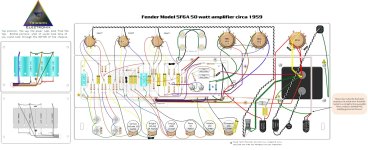

So you could probably use heyboer JTM50 transformers for a EL34 5F6A. This is the layout I made of the 59 Bassman using 6L6. And under that is my now finished JTM50 layout, which I just finished a couple hours ago. At least I think it's finished, I still have to do a second pass on all every connection to be sure I didn't skip anything.
I'm transitioning from premade chassis to DIY. I have a company that will laser cut any layout I have, and I have a sheet metal brake for bending the sheets into boxes. So I'm starting to think about things like modifying chassis to have custom switches, or ohm selectors, etc.

You can also raise the cathode resistor from 250r to 300r to give the 5e3 a bit more headroom. Sounds very neil youngish..... I live close enough to MM to pick up the transformers and save freight, and there's a costco really close so I can do a two-fer. I get "the good guy" discount because I've ordered over 30 transformers from them. Used to be that I saved money buying MM because of the freight and the discount, but even taking that into account the same transformers for a 1987 are about $250 *less* from Heyboer.....
Yeah MM aren't cheap! I wish Heyboer made a bigger range like MM. Plus ordering from Mercury has become more difficult since the passing of Patrick. For some of my recent 5F4/5E7 builds I've been buying the PT and OT from Mercury but the chokes from Mojo when I buy the chassis and tagboard. I struggle with spending US$60 on a choke! Most of the Mojo transformers seem to made by Heyboer but I don't like the sound as much as the MM trannies.
