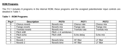

When playing guitar through the pedal the mix and level knobs affect the signal, but the others do not. The non-audible pots measurements change when they are rotated. There is no audible oscillation. The FV-1 seems to have normal voltages. Is there a signal path I can probe to solve this wacky mystery? Any perspective is appreciated. I am aware that I need to clean up the soldering and leads.
