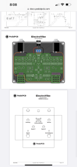

I’m sure this is asked somewhere but I did t see it quickly.
I was planning on using a normal spdt switch for the chorus vibrato mounted to the board. Looking at the template it appears that won’t work following the template.
1 am I correct in my thinking.
2 anyone know how much lower than the switch hole to make it.
Thanks.
Yea that’s what I meant was if I mount it to the board rather than doing off board wiring.
Ah, yeah. You'll have to wire it off board to fit the template. The standard toggle is too big to board mount, anyway
