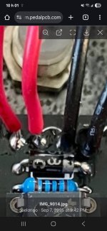

Replaced the footswitch with a new one that tested good, tested good after the breakout board was soldered to it, and when wired to the pedal has the same issue as the first switch. Except this time when the effect is activated there's white noise / hiss that wasn't there with the first switch.

I'll look closer and see what I can find.
Pokey bits into the back of the pot condom that pierce once the pots are tightened down?
Just loosen the pot nuts and see if it improves. Maybe jiggling the PCB a bit.
Let's focus on getting sound when bypassed first. (There's still no sound in bypass, right?)
With the pedal in bypass, no power applied:
Check for continuity between the Tip lugs of the Input and Output jacks.
Now check for continuity between the Tip lug of the Input jack and Ground.
Any chance you clamped down the pots on the input or output wire and shorted it to the enclosure?

I took it out of the enclosure and input wire was sandwiched between the gain pot and the enclosure. See the smashed insulation.
EDIT: I plugged it in out of the enclosure and have bypass and effect signals. However in effect the LED didn't light up and it doesn't seem to be acting the normal, but everything is jiggly, so I assume things are touching that shouldn't be.
I am going to replace that smashed wire and carefully put it back in the enclosure. And I will look at the bottom of the dust covers and see if anything pierced them.
Feel free to tell me if that's not what to do!
