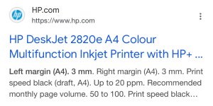

I'm trying to finalise a page in Inkscape with my first waterslide decals. I have 6 decals prepped, exported the PDF and did a print on normal paper to check sizes, and the page gets cuton the left and on the lower side... is there some setting I'm missing to check?
I am probably being greedy in trying to fit 3 125b prints in a row in an A4 page...
Printers can't print as wide as the entire A4. Just being greedy there ;) You need to increase the margins top, bottom and sides. Double check A4/Letter format. Better safe than sorry (but still make sure that you don't rescale when printing).
I checked resizing and everything is correct at least 😅... I found a way to add page margins in Inkscape and I found my printers margins (not an easy information to find apparently)
In my case, I have everything set to US Letter. I'll check the margins!
So yeah, I added margins and made sure to stay inside, now the print is fine

As a side note, why it seems like printers' page margins are a secret? I only found my printer's info (cheap HP 2820e) on the indian product page...
