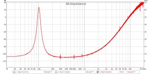

In my opinion, load box + reamp is the way forward. there’s good reason why the likes of the TAE, and power station, are so popular.
I built a reactive load box (tweaked values to match the impedence curve of my cab), I run tube amps into the load box, then reamp using a solidstate power amp so I can have cranked amp sounds at any volume. The amp reacts exactly the same as it does attached to the cab load so the only thing you sacrifice is SPL (unavoidable if you want manageable volume) and potentially speaker distortion.
I followed Randall aiken’s work to make my reactive load. He’s done the legwork here:
And there is a (long) thread on tgp of people who have built their own, including all the trial and error so you can skip that part
The first page covers pretty much all the basics.
The circuit is simple but the parts are large, expensive, and have specific requirements (like the cap must be bipolar, able to handle high current and high ripple, very low if any ESR. Inductors must be air core or act like air core and not saturate, and must be extremely low DC resistance). So don’t expect to save any money over just buying a good one (like the Suhr).
this kind of project doesn’t lend itself to pcb construction, better of just going point to point as who knows what size your parts will be. I used high end audio crossover parts from erse audio. Enclosure will also be large and bare in mind the enclosure material (steel vs aluminum vs something non-conductive) and size will affect your inductors inductance and therefore greatly change your load box’s impedence curve. I used an aluminum cake pan I bought off amazon since the hammond enclosures of this size were damn expensive.
if you use tube amps it’s definitely a project worth considering, as it can be fun to tweak a load box to your specific requirements. Though how sensitive your amp is to the impedence load does depend on the amp circuit. Some are very picky and some are quite happy with just a resistive load.
here is a picture of mine.

Good info here, I appreciate the response! I think for me, while obviously a little less expensive would be great, ultimately the thrill of creating it myself would be worth it alone. I kind of figured it might not be a cost savings venture, although I wished maybe a little.. lol But the experience would be awesome as well. Thanks again for posting the info, I will be looking at this all weekend I am sure!
Hey I just built this reactive attenuator/loadbox recently and posted some pics, the thread for the design is from the Marshall forum:
I haven't tested mine yet because I'm waiting on a tube amp, but it is a verified design. Other people have posted their pics in the thread too. I put a line out in mine for cab IR's etc. Not very many components and the cost was about $130 between Mouser and Parts Express but it can be done for cheaper.
