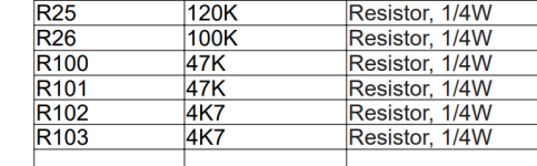

You probably need to adjust R103 to control the light level. Depending on the type of LED you use, the stock 4K value may not be enough to tame the brightness.
Mine goes completely dim (off) when the modulation level is at 0. And gets brighter as it gets turned up. It pulses along with the modulation rate.
R103? The resistors only go up to 30 for this build.
