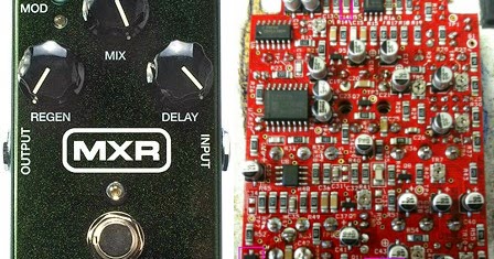

Hi Folks,
Recently picked up a broken Carbon Copy for $20. Original owner says "all of a sudden one day, the output became extremely quiet."
I get a clean signal in bypass mode, but when the pedal is engaged it's extremely quiet but I am able to hear delays (if I crank my amp way up). With Regen cranked it won't self-oscillate though. (A hint as to where in the signal the gain drop is happening?) I've tried with both battery and adapter.
I've attached a photo of the PCB and also the only source I could find online claiming to be a Carbon Copy schematic (low res, kinda hard to read).
Any tips on troubleshooting what the problem might be? (I'm still a novice pedal builder.)

https://www.freestompboxes.org/viewtopic.php?t=6559 where they suggest replacing SMD JFET Q10, and provide photos of the board.
I can't say which repairs might work, however I also own a dead one that I barely used so it sure seems that MXR has a bad design failure here. I just haven't decided yet whether to try my luck replacing SMDs vs brutally torturing it...
Hi, newbie here. Got a mini CC that died on me 2 months after the warranty expired. I hadn't touched the guitar or pedal board in a while, and when I finally did. the delay wasn't outputting any guitar signal, but rather a repeated disturbance. I've checked all the electrolytic capacitors, the SMD type, with my bench LCR meter. They all suck!!! Sub-par pieces of crap! Phase angle at around 60 degrees, capacitance way lower than a 20% tolerance calls for, not to mention varying high ESR. I've replaced them all, but that didn't fix the problem. I'm guessing these crap caps had taken out an IC upstream. This is extremely difficult to debug w/o schematics, but I've managed to verify the 4 coolaudio IC's are fine, and so is the SA571 compander. I've shorted one of the FET's (one of the Q10...13) with a small screw driver, and some analog signal became audible through my amp. Just ordered a bunch of MMBFJ177 (SMD FET), with the intention of replacing the suspects. This really sucks! I'm very disappointed with MXR, albeit I loved that carbon copy. Will keep updating.

Mine is broken too. Engaging the pedal increases the volume slightly but no delay. Messing up with the multimeter I managed to get some delay noises which leads me to think that the issue is within the bypass circuit
I found that the bypass uses some FETs and about the ESD issues being caused but had no success

There are a number of test points on the schematic. Those would be ideal points to test with an audio probe to see where things go sideways.
There's a fet buffer for bypass and a npn buffer before the first opamp on the top right of the schem.
Bypassing the in circuit but buffer won't fix it.
I would probe the test points, or the outputs of each gain stage.
If that seems too complicated, I would recommend not going further with any fix attempt, to be honest.

When you have one that does not work - C41 is another suspect. I just had one on the table where the echos faded away very fast, even when Regen was turned to max. The schematic linked here did fit the pedal I had in my hands very well. I checked all capacitors in the signal path while having the pedal switched on and having a 500 Hz sinus 300 mV peak to peak fed into the input. I did that both with a multimeter set to AC voltage, measuring accross both contacts of each capacitor and also with an oszi measuring each contact against ground. In both cases, I had significant voltage drop accross the C41 and none accross any of the other capacitors. C41 is replaced now and the pedal works again.
