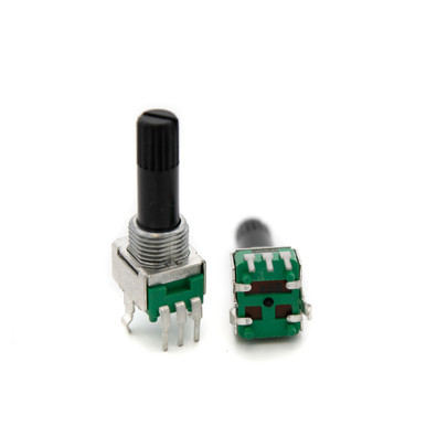

Does anyone know where to source the case mounted trim pot that c2c electronics uses on their prefab’d units?
That's the part, but you would need my XLR daughter board to mount it. The prefabbed units use a completely different PCB.
