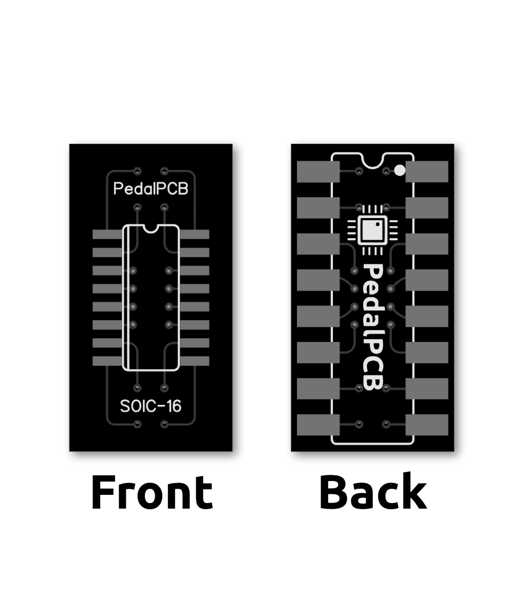

Any recommendations for cheap SMD to DIP adapters that could be used for PT2399? I feel like there's probably something out there but the search term seems to be eluding me.
Or perhaps it would be worth ordering a sheet of custom scored PCBs just for this kind of thing?
To me youd have to be using an awful lot of them for the effort to make sense for the cost savings. But if it made sense id just make them in diptrace would be quite simple. Or i think robert sells some

To me youd have to be using an awful lot of them for the effort to make sense for the cost savings. But if it made sense id just make them in diptrace would be quite simple. Or i think Robert sells some
For SOIC-8 to DIP-8 I just buy half a dozen through OSHpark every year or two, at $0.95 for three, shipped. As you say, doing your own layout is dead simple, and there are probably design shares at OSH if you look hard enough. But I'd just buy bigger ones from Robert if I were already ordering something from PPCB that needed them.
