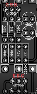

Hey guys,
Just finished the circuit on a sabbath distortion. I alligator clipped it to test and I get virtually no signal coming through. The signal that does come through is incredibly faint and sounds not distorted. The pots appear to sound correct (volume, gain, etc). I did test the pots before soldering them in. Here are the voltages for the trannies, pins reading left to right:
q1 0 2. 8.7
Q2 0. 1.6 3.7
Q3 2.9 4.8 8.8
Q4 0 0.6 4.2
Q5 2.9 5 8.8
Q6 2 5 8.8
Any assistance would be greatly appreciated. I know I can count on you guys to help with this.

Pn4393 from NTE Parts Direct as a substitute for MPF4393. The BC184 is from Tayda.
Edit I learned real quick to steer clear of eBay for most parts
I have a sabbath build that also doesnt work, but because of the transistors that I havent ordered! The bc184lc from Tayda however is a reversed pinout I believe, so you have to mind that? I also understand mouser makes reliable pn4393s, thats what im waiting to order.
I have a bc184lc from tayda. I’ll do some research in the pinout and see if that works. How can I tell what the pinout is supposed to be on the board itself?
I use the shop pcb image where you can see some traces and compare to the schematic e.g. you can see the BC184 has a 4K7 on the emitter in the schematic and image 10K collector so EBC left to right
With the fets looks like GSD left to right from the fet with the 470K, 820R and 1K coming off it 2nd from the right (Q4 in the schem I think)
Just for info the shop images can be handy if the schematics not been posted yet doesn't show every trace but if you look at the 22u ground pad you can see it's got faint lines surrounding it so you can suss ground pads too

I don't think Q1 emitter should be 0v you may have a short around there and I suspect the collector voltage is a bit high with the 10K coming off VCC I'd check around your transistor socket C4, R4 and 5
Unfortunately I'm not proficient enough to work out what the emitter voltage should be but I'd think a volt or 2ish
Q3 ,5 and 6 gate voltages should be nearer half VCC (8.8V) they've all got equal resistance voltage dividers from VCC to their gate pins

Q1 is cutoff. Make sure R1 & R2 are the right values, check solder joints, the usual. And of course make sure Q1 is facing the right way. Transistors will work when E & C Are swapped, their hFE is just a LOT lower. Pull Q1 out of the socket and measure the voltage on the middle pin of the socket. Also make sure the transistor leads are snug in the sockets.
You have a cheap DMM, it's loading down the circuit when you measure Q3-G, Q5-G & Q6-G. Ignoring the bogus readings, it looks like the JFETs are all working correctly.
I notice tayda have the BC184 and 184L listed together and they have very different pinouts and I've just noticed you say you've got a BC184LC
The BC184L / LC has the base as an outer pin so it wouldn't make a difference just turning it around 180° you'd need to turn it around and bend the B and C pins, B to the middle C to the right, from the image below if you put it in per the silkscreen it'd be Base, Collector, Emitter and you want Emitter, Base, Collector
Meant to say I'd checked all your resistors, caps etc all looked correct but as @Chuck D. Bones says check them again...and again....then ask your neighbour to check them!
That would explain the problem, good catch! Turn the transistor approx 90 deg, form the leads so collector & base are swapped, plug it back in and you should be good to go.
Alternatively, use a different transistor for Q1, nothing special about BC184. Any NPN Si tranny will work. I recommend a low noise tranny like 2N5088, 2N5089, BC549, MPSA18, etc. Mind the pinout of course.
Wire insulation is ok, but air is a fine insulator. Think in 3 dimensions, you can easily form the leads so they go into the right holes and don't touch. Rotate the transistor 45 deg and you'll see what I mean.
Success!! Sounds much better now. I didn’t realize the pinout was different for a bc183lc vs bc184. I move the pins and put some electrical tape in between.
