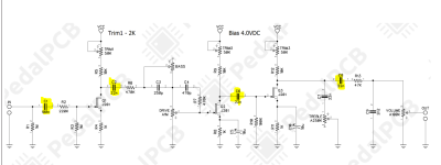

I built the SOB a year ago, but it's just not getting a lot of use on my bass board as it cuts too much bass frequency.
Would changing C1 to 1UF be enough? It's currently 100n.
EDIT: I ended up switching out C6 and C8 for 330n (what I had on hand, though I think anything 100n and above would have been fine). That really opened up the pedal and makes it sound a lot fuller and more useful on bass
You'd want to look at the other deoupling caps as well and up their values. IMO if you tune this for Bass it may not sound good on guitar. You are seeing the opposite right now. Your best bet is to socket the components or attempt to breadboard it and tweak to your liking.
That makes sense... I'm not interested in making it work for guitar, only bass... so totally not worried about tweaking it. I changed the coupling caps on my muff, so maybe I'll just go that route here to make it more useable.
Do I need to change the resistors that follow?
No, just change all the highlighted capacitors. You should compute all filter corner frequencies for each stage to get the right value, or you can just go by trial and error, like start with doubling all the values.

A good starting point would be changing the input cap to 1uf and the decoupling caps to 100n and go from there. Those are some ballpark values to start with

The problem with the corner frequency calculator is that you have to figure out the equivalent resistor for each stage to plug into the R value. The resistor value will depend both on surrounding resistors and on the transistor bias point and configuration. In short, it’s not trivial and you would need to do a lot of analysis. Alternatively you can plug the circuit in a simulator (like spice or partsim) and let the software tell you the bandwidth. That’s also an easy way to check how different component values affect the frequency response. Keep in mind that once clipping or distortion kicks in, the frequency analysis goes out the window and you may have to do transient analysis.
I ended up switching out C6 and C8 for 330n (what I had on hand, though I think anything 100n and above would have been fine). That really opened up the pedal and makes it sound a lot fuller. At least on my bench rig, it sounds great! I rebiased the JFETs as well. I did that correctly when I built it, but things were a little off there at this point. It sounded much better after that as well, though I wish that the OD was a little bit smoother. I'm going to go in and tune the JFETs by ear (3 to 2 to 1) to see if I can smooth things out a little bit. If not, I can always go back and rebias it to spec with my meter.

If you don't have the right cap you can also adjust the value of the resistor. Lowering the resistor value will raise the cutoff frequency. SInce this is a high pass filter it will allow frequencies ABOVE the cutoff to pass through
I'm assuming that's in the opamp feedback loop. You need a RC filter to "tell" the opamp what frequencies to amplify. If wont work without it; I've tried it on a breadboard.
I think it is in the opamp feedback loop... so that's interesting because the circuit is now amplifying too much of the low frequency. That makes more sense now.

All those online calcs do is tell you what the corner freq is. The position of RC to CR tells you whether it's a high-pass or low-pass and so long as you can determine signal flow you'll know which is which, which to use etc.
Above all, trust your ears. Something works for you, your gear, then it's good. If you play a P-Bass and love the sound, what does it matter if your guitar-twanger friend says it's "too muddy" with his/her humbuckered-LP.
YOU said it was too muddy at 400n, so back off to 330n if you've got some and then 220n...
If you don't have a value you want here's a couple of ways to cheat towards what you're after and or get in-between Goldilocks' settings of "just right":
400n in series with another 400n will get you 200n!

Also, the "elbow" varies with how you achieve the corner frequency, but nothing is abruptly cut off, there's always a taper, so having a 400n with a 4k7 gets you that 84.7 Hz, so does 220n + 8k5 (close enough). The taper surrounding the corner freq changes between the 400n/4k7 and the 220n/8k5
