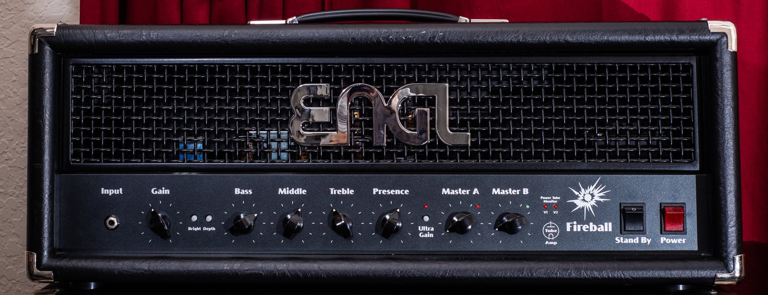

I assumed if you short circuit a capacitor or a resistor it is essentially out of the circuit because electricity will take the path of least resistance and since the resistance of a bare wire is near 0 that's where current will flow. Then I was looking at the schematic for the Engl Fireball and noticed the depth switch at the beginning, see the snapshot below, full schematic at https://el34world.com/charts/Schematics/files/Engl/Engl_fireball.pdf
Shouldn't it make no difference if the cap is connected or not since it is shorted anyway?
It's allowing certain frequencies around the pot from the looks of it.
Since the gain pot induces resistance, the depth adds a parallel alternate path of less resistance , frequency dependant via cap values.
I don't see a depth switch on the panel of a fireball anyways.
Only on the 60 and 100, not the little 25.
