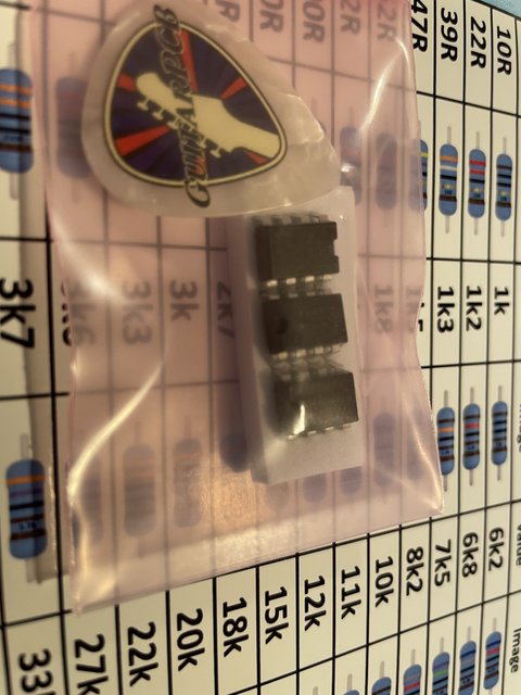

My 4 Knob Flange chip just came in so not to bad on shipping time. May order the StompLFO chip just to have it.
