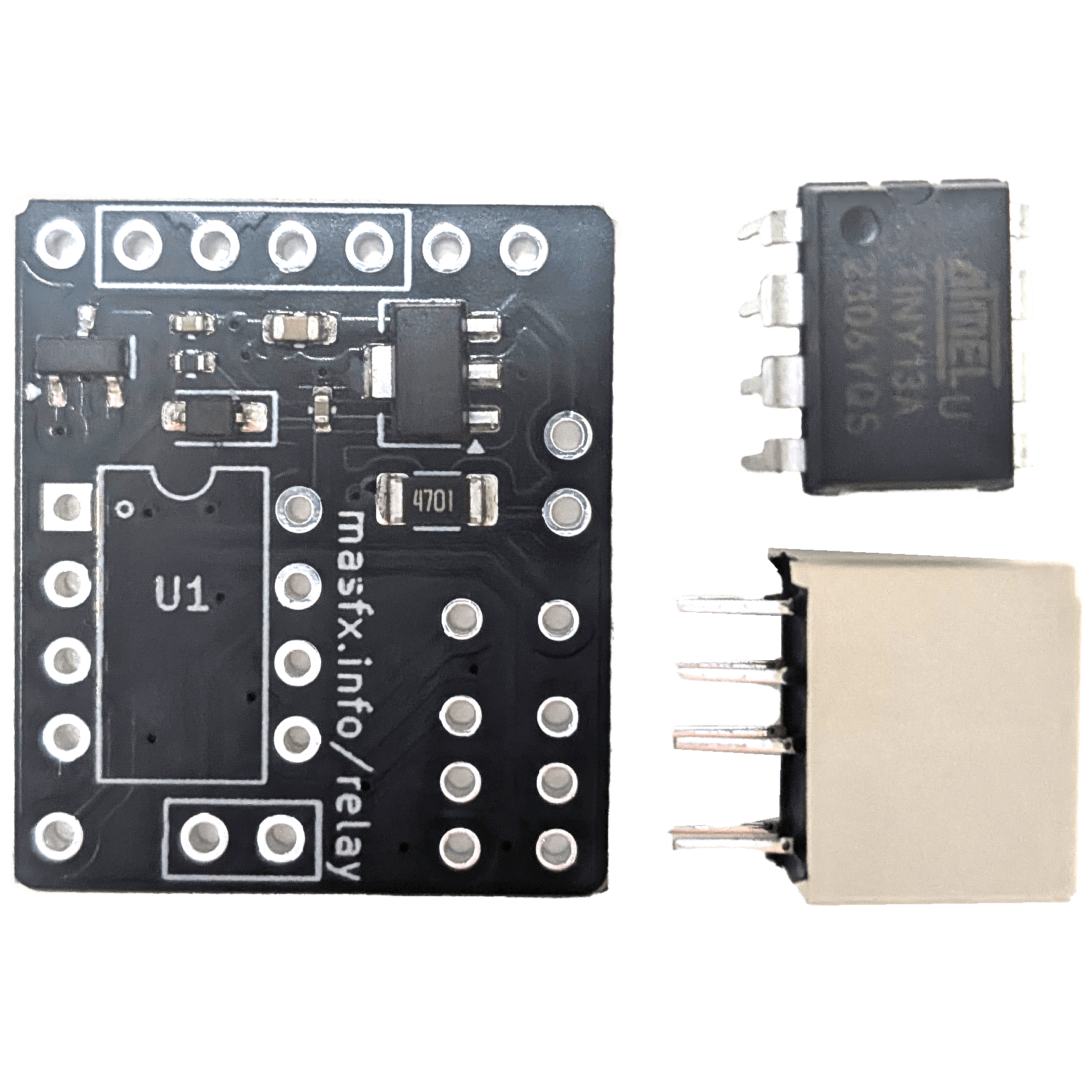

This is a bit superfluous but I've always wanted to try out the ATtiny for soft touch control. I made another version of the Volume-only PCB with an ATtiny25/45/85 socket to handle power on delay and soft-touch foot switch. I started with the MAS effect code and implemented mine using the same pins for the controls. MAS effect info starts here:
Of course, you could just use the MAS switch with the relay being used in place of the NPN transistor in my schematic below. Just reprogram the ATtiny to add power-on delay or configure it to power up bypassed all the time so it only comes on when told to do so. But, the point of this was to dig in deep even though duplicating what I already have with the discrete soft-touch toggle flip-flop.
Schematic is dirt simple. EDIT: After measuring current draw to be 26mA, the voltage dropping resistor is changed to 470ohm 1/2W. With ~23V input, the resistor drops it to 11V to the 78L05. Then power in the 78L05 is 160mW. EDIT AGAIN: Current varying between 22mA and 34mA. A resistor is futile. Changing to zeners... I'm using two 6.2V zeners on mine to drop from ~23V to ~10V. A single 12V 1W zener was getting a bit hot.
