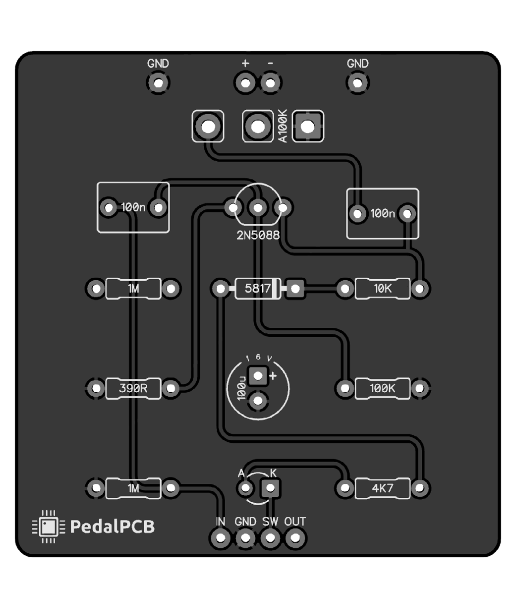

I went back and read more on this thread about it needing a buffer in front, so I ordered 2 JFET buffer boards from pedalpcb.

The jfet buffer boards are unity gain. Not useful unless you modify them to work with 24V and get some gain. Need about 10X voltage gain to drive the amplifier board. Instrument level is around 200mV but the amp wants about 2V signal. Everything on a pedal board is going to be instrument level all the way to the final stage.

The buffer board is a source-follower circuit. It's only option is unity gain. It's of no value. The line-output of the HX stomp can drive the TPA3118 directly. But, I would still suggest building something a bit more versatile.
