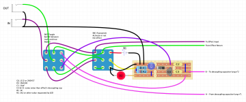

I'd like to add trails bypass to an existing pcb (in this case the FV-1 Arachnid), without modifying the pcb itself. Would the concept depicted in the illustration work? The board output is buffered, that's why I only added a buffer to the input signal.
If not, what would I need to change to make it work? Or are there any other solutions already available maybe?

That could work, theoretically, @TieskeP.
However, you don't need that extra buffer, just cut the signal-input to the board on bypass.
The buffered output is what makes tails/trails work. Board's output could be routed directly to the 3PDT's lug-8.

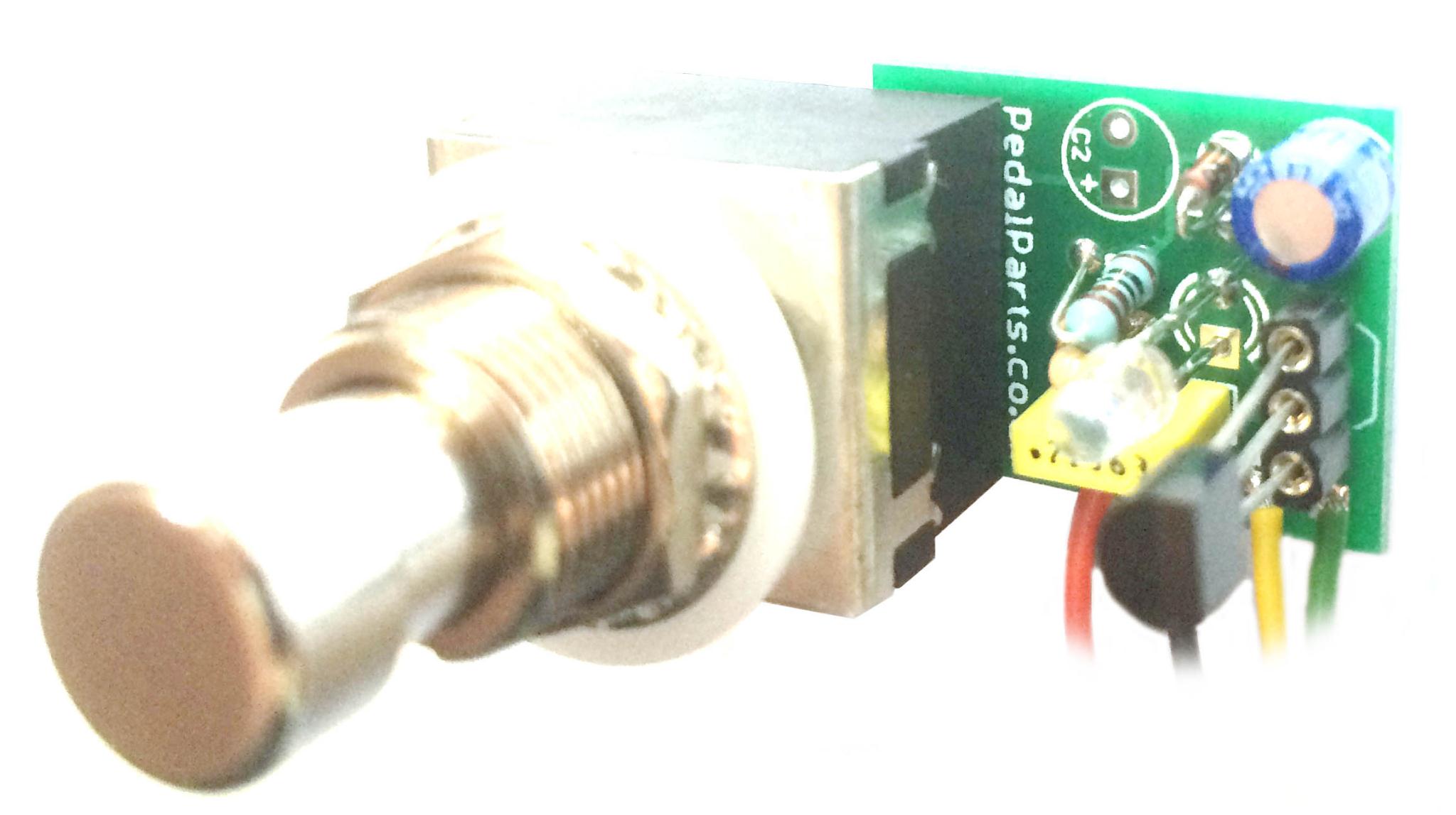

There are DIY veros and perfs and how-to articles to add tails/trails, and there are PCBs for it too, such as these from Fuzz Dog:
Of course, you could just McGyver something from examining the Fuzzdog Tails/TrueTails build-docs and not spend money on the PCB.

However, there may be some feedback or phase cancellation. Maybe take the output from the FV-1's pin that outputs the repeats only. Consult the FV-1 Datasheet PDF, I'm by no means an expert on any of this, let alone FV-1.

Hi there,
I worked on a vero version of the tails PCB (https://shop.pedalparts.co.uk/product/tails) that you'll find the schematics bellow
So I made this thing hopping it could work. This is "designed" to allow to switch (SW2) between True Bypass and Tails mode:
If anybody have time to check this and give me a feedback, it will be really appreciate :)

Wouldn’t leaving out the buffer in the proposed schematic potentially cause issues, since you’d mix a buffered output signal from the effect pcb with the unbuffered input signal?
The kits you suggested might work too. I think I could try replacing a decoupling capacitor just before the FV-1 chip with the in- and output signals of the bypass pcb. That would be similar as to how it’s applied to the PT2399 delay kits.
The only thing I have doubts about is that the mix control on most FV-1 controls is a bit different than in most PT2399 delay kits. In the FV-1, you can go full wet, which would mean that in buffered bypass mode, there is no signal when the mix is set to full wet (after the repeats have trailed off)

I think your Vero schematics should work like that. Let us know how it works out for you 🙂
C17 seems to be the decoupling capacitor that you should replace for the D’lay to get the trails bypass indeed
What about an optocoupler to mute the input to the FV-1 instead of one of the poles of the switch? That way you don’t get a big footswitch pop as the last thing in the tails of a long reverb wash when you bypass it.

With the suggested bypass pcb, the switching is actually done with the JFET transistor, this should mitigate the pop noise issue you’d get with a mechanical switch. But an optocoupler could be an option too indeed. This doesn’t solve the issue I see for the mix knob though - in bypass the mix knob is still in the audio path, which wouldn’t work when set to full wet.
