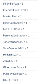

Another vote for the Square Wave, though, all the suggestions so far are great — I'd lean to the FY-2 if you've already played around with the Square Wave before. Always fun to have something new.
Tossing in a Toonie (2¢ after inflation adjustment):
ESR Graphic Fuzz
Penny Finger Print
@DGWVI
ESR Graphic Fuzz
Penny Finger Print
I think I might still have some Finger Print boards on hand. If so, I'll build one up and see if I like it enough to put in one of these
The Square Wave is KILLER. Criminally underrated. If you do it make sure to put a feedback cap across the first transistor to quell the noise - I’m on my phone otherwise I’d link to details but it solves the noise issue without impacting how brutal it sounds
@DGWVI
ESR Graphic Fuzz
Penny Finger Print
