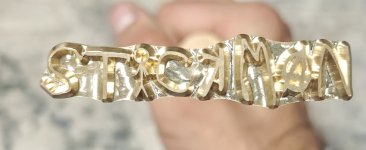

Ohh...and also got a little something for the un-branded necks. Cause imma mark my territory like a jealous tom cat.
(I mirrored the image, it's actually backwards. But this way your brain doesn't have to flip it).
