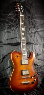

As some of you know, I build guitars as an avocation. As I say goodbye to my pets, I like to build a guitar in their memory. I have two models called the St. Humphrey and St. Lily.
This guitar is called the St. Daphne.Daphne was not long for this world. We had her for two years; she battled asthma and congestive heart failure. Despite a strict regimen of treatment and medication, she passed suddenly of a blood clot.
Here is the guitar in her memory.
So why is this here? When routing the top for recesses for the knobs, I screwed up, plunging my router a bit too soon. To make the controls somewhat symmetrical, everything had to be squashed in.
The layout never looked right and bothered me. When placing knobs on this top I noticed it looked purposeful if I put two sets of different knobs instead.
That begs the question, why would you put different knobs on a guitar? Only if you put a PCB in it. @JamieJ suggested the Electra distortion. Some research showed the MXR Distortion+ was a close relative and was a PCB I had on hand. So in it went!
I really don't know why onboard distortions aren't more of a thing. This guitar sounds ace with it and it's versatile to boot!

Very nice build! Did you shape the body from blank yourself?
Yes indeed. For all my shapes, I make a template from 1/4" plywood.
I will cut the blank out as close as possible to the edge and bolt up the template to the top. I put it on my routing table where the bit will shave off the rest and a bearing will follow the template.
