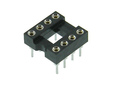

Definitely want to socket the IC. Fwiw I think you’d be fine to sub a TL072.

I actually prefer the cheaper cinch sockets from Tayda or Digikey but I also really like supporting Nextgen, which is as close to local as I can find.
