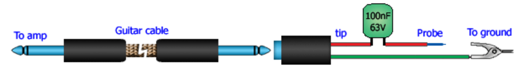

Looking to make an enclosed audio probe and am looking for some inspiration/insight. If anybody has done it and can share I would be very appreciative. I have what I think is all the material to put together but need some direction.
Here's the tagboard effects one basically a test box with integrated audio probe 2 of the most important debug tools in one
with this you can test your circuit prior to boxing it up and if it doesn't work flick a switch and start probing immediately, you can substitute some parts like the speaker connector just use a terminal strip or croc clips or whatever well worth making this

If anyone is interested maybe for future reference.
