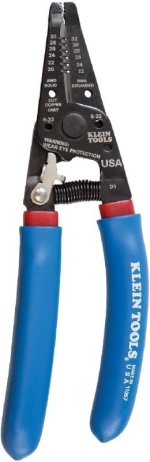

I use this Klein, and I'm pretty happy with it. I'd love something compact for tight spots, though... preferably not seventy dollars, good god!
