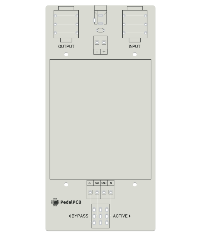

I have used these ones (#2 in the original post) for a long time. I found the the nut on them would sometimes loosen over time and the DC jack would start to spin in the round enclosure holes. But there are 2 sides of the plastic part that are flat.....so after a few Tayda drill service trial & error attempts I came up with a pretty good approximation of profile of the plastic part using 12 individual line cuts. You can see the line segments I use below to make the outline at the end of the red arrow. Sometimes it is a tighter or looser fit to the DC jack, but in about 30 enclosures it has always fit and with this profile I have not had any spinning DC jacks - plus I find it a lot easier to tighten the nut.
