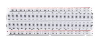

Then there's something like this, which is a brand name (BusBoard): https://www.amazon.com/gp/product/B0040Z4QN8/ref=ox_sc_saved_title_4?smid=A2RKGEIGG4B1JT
With the second one I'd need to get jumpers and little jumper wires, which is not a huge deal. In that case I can shop around for (potentially) better jumpers. Worth it to spend twice as much? Or just get that full kit?

I can't say I've ever bought a name brand breadboard, but the generic ones are hit-or-miss. Tayda usually has a pretty good deal on breadboarding stuff.

@synthesiserror - I realized I should probably get one RIGHT after my Tayda shipment arrived. Doh! I've bought some Allecin stuff from Amazon before and they seemed fine... I'll probably give it a go. Do bad ones just have dead areas I wonder? Wear out fast?

Sometimes they just don't grab leads convincingly. This is mainly a problem with thin leads on cheap resistors and crusty vintage components.
Ahhh ok. That sounds like a pretty bad problem to have, and has me thinking about the BusBoard one again... Hmm.
I'd say so! You can get a lot of mileage out of a board like that. You can definitely build Electras and all manner of classic transistor fuzzes on something like that to your heart's content.
Hmm. This BusBoard one might be the better bet after all... Is this size big enough for the relatively simple fuzz circuits I'll be monkeying with, you think?

The Buss boards are good quality. I have a few of the 30 row ones but should probably buy a 60 at some point.
A breadboard half the size of that one would probably be plenty for any simple-ish fuzz circuit. Nothing wrong with going larger though. Better than having one smaller than you need. I use 3M breadboards these days which are very expensive compared to most but they are fantastic. They might grip too tightly for some people's tastes but nothing is coming loose from those unless you want them to.
I'd suggest getting an inexpensive one first and making sure you get enough use out of it before springing for an expensive one though (and even then it's probably overkill for most). But the quality of the 3M ones is top notch.
Thanks everybody! The BusBoard I posted above should last me a while, and I see no reason to skimp - seems like that may turn me off to breadboarding altogether if I get a wonky one. 3M looks fantastic, but I think the BusBoard is gonna get the job done.
