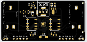

This is my first shot at a PCB - I went for an MXR Il Diavolo, one of the first pedals I really liked. I wanted it to be a certain layout so it can fit it in a double board project I have in mind.
It was difficult to figure out the priority some of the components need when being laid out. Also, the ground pour wasn't cooperating and in my haste I forgot to attach it to the ground net before sending it to JLCPCB. Nice. But the verification checks came back good!
These pics show after I fixed the ground pour debacle
There are a lot of vias.. is that bad?
I try my best to not have them but I haven't seen anything that says having them is bad in a simple audio circuit. I'd be more worried about running audio signal traces right next to power traces. However, I'm sure someone will correct me now that I've said something. :)
Dang, I never even thought of that. I'll try to keep that in mind with the next one. The power is DC and the signal path is low voltage so hopefully it'll be ok!
Great job. Plenty of my boards have a lot of vias, generally they aren't an issue. I do try and minimise their use as much as possible because often the layout or component position could be better and the via wasn't actually needed.
I have marked out some things I would try and avoid on your boards, particularly right-angles in your traces and having the silkscreen overlap with your pads. Otherwise looks great for a first board tbh. Good luck with your project.
For years I've avoided them like the plague, only using them as a last alternative when I'm on the brink of losing my mind. 🤣
Lately, I've started to realize how much cleaner (and less stressful) some of my layouts would have been with a few vias. Technically it's really no different than a trace that passes through the board at a through-hole component pad, and I do that many times in a layout.
I would suggest nudging the silkscreen (or the vias) slightly in cases like this. That value will probably be unreadable.
What's the radius on your rounding in the corners?
I don't actually know 😬 Grid size is 25 mils here, because the total board dimensions weren't working at 50, which is normally how I like it.
I think in the earlier days of DIY scene EDA, it was a badge of honor (and economic necessity) to keep a board at 2 layers, and then create a layout without adding vias at all. And while I've got that still stuck in my craw for my own layouts, I'm not going to hold it against anyone! I used vias extensively in my early boards, and there's no shame in it. Sometimes it's also required to link some islands of ground planes, if you've got them in both top and bottom.
If you're doing a lot of SMD work, it's a h*ckin necessity, because you've really only got two layers for the surface components, and then internal layers for supply and ground planes.
