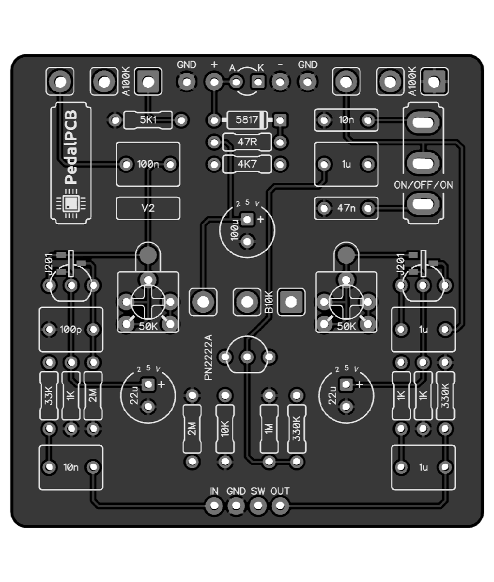

While the original version 2 has a Vol Pot of 100KA,
Chop Shop Overdrive has a 10KA Vol Pot. Have you tested this difference?
There are three differences that I see compared to the Gray Bench schematic.
A100K vs A10K volume pot
2N2222A vs PN2222A output buffer transistor
Sag pot behaves inversely (turning up the Sag increases Sag in the Chop Shop, which just seems more logical)
Sonically I don't think there will be any difference but the pot / transistor could easily be substituted by the builder if they desire.
If there's enough feedback requesting it I could reverse the Sag pot I suppose.

Crank up the volts all the way to the right, turn them down to the left. Makes total sense.
Want sag? Turn down the volts to the left.
Yep, I guess so.... but then shouldn't it be called "Volts" and not "Sag"?
If I turn up the Sag knob I expect more... well... sag. 😂
We can pull a "Timmy" though and just consider it a Sag-cut control.
Why not commit fully to the Chop Shop name and make the others volume-cut and gain-cut too? Think of all the UV print thematic possibilities!
