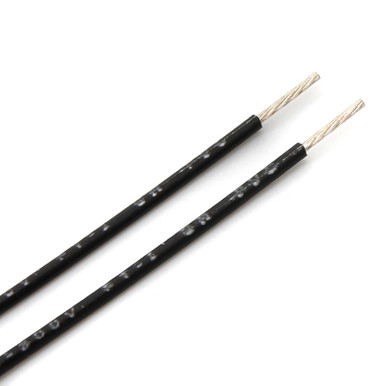

I mostly prefer using solid core wire. I have had a hard time in the past getting the stranded wire cleanly into the holes. If it was tinned it wouldn't fit in the hole and if it wasn't tinned there were always oddball strands left hanging out on the entry side. Probably an issue using 20 awg or 22 awg wire. The precut and prebonded stuff stompbox parts sells works really well though. I've switched to using that when I'm using 3pdt breakout boards and I save the solid core for the jacks.
Yes I did my research and bought some 24 AWG stranded pre-bonded wire from LoveMySwitches. It seems to work very well but seems expensive at $16.99 for 100 feet. I have a wire stripper tool so at least stripping the ends is easy.
This is what I have been using:
It's pricer than buying rolls of wire, but the convenience of having precut and stripped wire is worth it to me. I'm have arthritis issues with my hands and squeezing the wire strippers repeatedly is no bueno.
Last time I ordered some I got 1.5in pieces and they work great for the 3pdt switch to main pcb connections.
