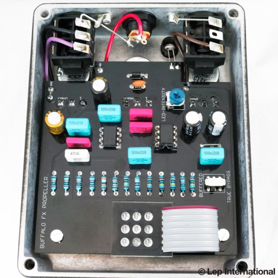

Anyone ever run into this?
I've been trying everything and nothing seems to get rid of a fat honking buzz.
If anyone has any tips on how to narrow it down I'd love to hear it.
I had it on my test board and it had a slight buzz, I figured it might be a grounding issue but after baking it it's annoying ass hell.

for starters, move the input wire so that the route doesn't cross under the board.
then I would move on to verifying that jack ground has continuity with power ground has continuity with all the board grounds ... then all the points in the schematic that go to ground ... also, there's no real need to wire across the lugs of your in/out jacks. if they're shorting, run the wires to the side that lifts when the cable is inserted as any additional wire is technically an antenna

You have used plastic In & out jacks from what I can see, You have No Ground from PCB & Jacks to the enclosure!
Try running a Ground wire from Ground pad to the enclosure with a Lid cover screw to see if that cures your issue.
If it does solve your issue, Solder the Ground wire to the star washer on the Footswitch, make sure it is to clean aluminium surface inside the pedal on the threaded area of the Footswitch so when you tighten Footswitch nut it is a good Ground.

Done and done. No change.
I have to say that your Build deviates from the BOM by using fly wires to your pots
This creates more wire & double the solder points!!!
Can you show a Picture of the Back of the Board????

You're still expected to ground the enclosure properly with a pre-fab PCB. You don't need rivets and lugs, but you definitely should ground it by some method. This is generally why most folks use metal frame jacks.
The long wires from the pots could be a source for noise as well. The PCB was designed for PCB mounted potentiometers.
This may or may not be the cause of your problem, but it's two of the most common sources of noise in a build.

The pot wires wouldn't make this sound. I've grounded the pcb all over. I've tested continuity of ground.
No where in the build documents does it say if you don't mount the pots to the pcb directly you'll suffer a build destroying buzz.
High gain fuzz circuits are very susceptible to noise due to wire placement, especially the input/output wires. Try running them as far away from the transistors as possible, yet keep them as short as possible.
