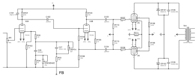

I was talking to my friend that I bounce all my ideas off of and he reminded me that the general consensus is that the power section of the Fryette D60 is the same as the main part of the Powerstation. This schematic doesn't have the reactive load (some good reading on those here) and is missing the warm/brite switches, but it will get you most of the way there. It also doesn't have the power supply, but you can generally design that yourself based on the needs of the circuit, which also allows you to scale it if you want to use different tubes. I'm partial to EL84s, so if I were to design something like this for myself I could scale the power section to be more suitable for EL84, and I can choose a 15W design or a 30W. You do you.

Thanks for the schematic, what would I need to do to make a loadbox as transparent as possible?
Depends on what you mean by transparent. With a load box you're typically more concerned with feel than with sound. You can use a single 8ohm 100W resistor and call it a dummy load, but it will feel stiff and uninspiring. Most higher-end boxes (including the powerstation) use a reactive load, which has an inductive element to it aside from the resistive element.
A speaker is not a perfect load. It has a different impedance depending on the frequency of the input signal. A resistor, on the other hand, has the same impedance regardless of the input frequency. The goal of a reactive load is to mimic the imperfect response of a speaker for a more natural feel.
Now how important this is will depend on your use case; if you're going to be using the external power amp to drive speakers and that's the only use for it then you may not notice much of a difference. But if you're going to a direct out for recording or through headphones, you'll notice a different feel.
