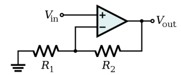

I'm trying to understand more about what gives certain pedals their freq response.
A lot of it comes down to:
-high frequencies go right through a capacitor, almost as if it was a short.
-low frequencies see a capacitor as a high resistance. The larger the capacitor, the lower the frequencies it “lets through”.
In a non inverting op amp, the gain is set by:
G = 1 + R2/R1
(Image from electro smash tube screamer article)
In the case of the tube screamer, the combination "impedance" of C4 and R8 will act as "R1" from the image above. (Impedance means resistance that can change over frequency). Low frequencies will see C4 as high resistance, making "R1" higher, which makes the gain lower. High frequencies will see C4 as low resistance, so "R1" is lower, so the gain is higher. The frequency where lows start to noticeably reduce depends on the equation f=1/(2piRC) where R is R8, and C is C4. This is the same equation as for C5 and R9, even though it is a different arrangement.
For C3, highs use it to bypass the gain pot, so that the equivalent "R2" is lower. So lower gain, so highs are attenuated. Low frequencies are resisted by C3 so the equivalent "R2" is higher.
So pretty much any of the filters, you can puzzle out what it does by considering that a capacitor lets highs right through and resists lows, and thinking of how that affects the gain.

The Distortr tone circuit is the same arrangement as a Big Muff tone control. As the treble turns up, lows go down, and vice versa, like a see-saw. Big muff tone controls also tend to scoop out the midrange. I put the Distrotr values into "TSC-in-the-web" on the Big Muff tab, and it actually doesn't look like it scoops mids very much, but the see-saw action remains. It may not be the best tone stack for you, maybe you like a simpler adjustable low-pass like on the Timmy circuit. Ironically, the Amber OD uses that same big-muff style tone stack, but that 1M resistor (R19) makes it hardly cut any bass, so it basically just acts as a low-pass filter. The Luxury is a really similar circuit to the Timmy, though some values are different so it won't sound identical, but it has that simple low-pass tone control.
