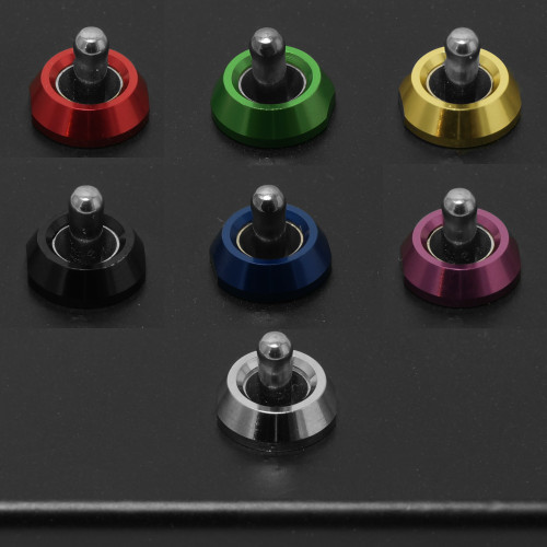

The larger nut looks killer - I wish someone made something similar for toggles
Yeah, I dig the beefier nut for sure.
I bought some of these Taiway dress nuts from LMS but I keep forgetting to install them before soldering the pots and switches. They are so shallow that if you don't fit everything else to sit at the height that those nuts allow for there will be a pretty significant gap between the enclosure and the nut. One of these days I'll remember!
I came by the toggle dress nut for my Parenthesis - if they had a beefy hex nut to 'match' the stomp switch nut you used THAT'D be the bee's knees.
As well I came by round, knurled shallow flat nuts for both stomp and toggle switches - options is good!
I bought one of these, and it didn't fit the 3PDT switches I have, did you have to have a certain switch for it?
I've used it on these two without any issue. I have some from Tayda that I can check tomorrow if you'd like.
Yeah, a mini version of the foot switch ones would be rad. Whenever I order from LMS from now on I'm just going to grab a handful of a different color - I really like the way they look.
