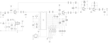

I want to have have a Hardwired Bypass switch designed into my stomp box. I did a search and couldn't find any info. New to the forum.
I'm building the Arachnid PCB. Sorry this is simple but I want to make sure there aren't any other circuit mods!

What do you mean by hardwired bypass switch? True bypass? The build docs show the wiring diagram for true bypass.
you can check out the build reports too to see how others have done it. Almost all the projects on here use true bypass Switching.

OK True bypass. I figured it was already designed in but on the build doc schematic I did not see any switch wired in for True bypass.
I think you're saying follow the wiring diagram for the 1/4" jacks and that will give me True Bypass.

Yeah the stomp switch isn’t shown on the schematic.
the next page on the build doc shows the wiring diagram for the stomp switch (true bypass). Only a few projects on here are buffered bypass, the vast majority Are intended for true bypass.
