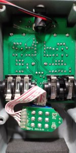

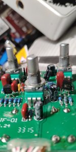

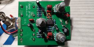

Anyone has a clue on what is this based on? Appears to be tailored to JiBin preferences, but I don't have the skills to even describe the topology, (I'm more of a lego builder to save money type). Love this thing with low output humbuckers.

That board says JF-01, so it's basically a tube screamer topology. You can see some tweaks, like two diodes instead of one for the clipping, and a 75558 chip.

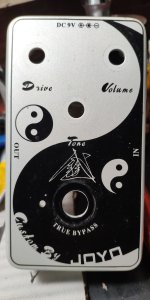

I would have guessed Zendrive as well just going by the enclosure graphics, but JF-01 is the same PCB as the Vintage Overdrive so definitely a modified (or not so modified) Tube Screamer.

Coincidentally, Joyo discontinued this pedal, and then they made another pedal that *was* a ZenDrive clone called the “Tai Chi”.
And for some reason didn’t reuse the already-perfect-for-a-ZenDrive-clone graphic?
