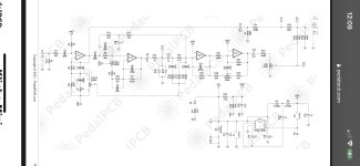

Hey guys. I want to build a kliche (klone) but I don’t have the 12v 1 watt Zener called for. I do have some 9.1v Zener. I believe it’s limiting the voltage reaching the charge pump. So couldn’t I just use my 9.1v? I saw on another forum that you probably can. But I trust you guys here so any help would be great.
