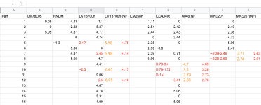

Here's what I got for voltages in my working unit vs the non-working unit:
There were really only minor differences between most of the values but I highlighted the main differences in red and the parts in the nonfunctioning unit are marked with NF in the header. In the functioning unit there's voltages that are fluctuating, but in the nonfunctioning unit those voltages are static and also a few volts off. For instance terminals 9, 10, 11, and 12 on the CD4046 aren't moving in the NF unit aren't moving and are very different. Also on the LM13700n terminals 6, 8, 11, and 13 are all moving a bit but in the NF unit they're static and about 2 volts higher than they should be. On my MN3207 terminals 7 and 8 are both around the voltages in the functioning unit, they're just not moving.
Thank you for sharing these! I get strikingly similar bad voltages, at the same points (orange on the image). I also measured voltages at the MCP602 and they look wrong:
1 (VoutA): 0V5 (VinB+): 2.15V
2 (VinA-): 0V6 (VinB-): 1.83V
3 (VinA+): random7 (VoutB): 5.04V
4 (Vss): 0V8 (Vdd): 5.05V
With no fluctuating signal coming out of MCP602 pin 7, that explains the CD4046BE pin 9 voltage, and maybe the other voltages as well. I'm getting new MCP602 chips tomorrow, and will share the results.
Tried out new MCP602 chips today, but no luck - voltages are unchanged.
Will report back if I eventually sort out the issue
Working now! I took the PCB out of the enclosure to check solder joints, and suddenly it was working when checking with an audioprobe! I think the issue was a short at the back of the stereo potentiometer, I did have insulating tape there, but one of the solder joints must have poked through, and made contact with the potentiometer. I'm using a double-layer of tape now, that seems to have done the trick!
