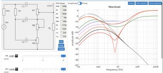

I used SMD J201s from PedalPCB, all biased with a DMM to to 4.5V. The tone is set by ear. It sounds great and just like a JCM, but each of the four EQ pots do very little. The difference between max and min on each is no more than `15-20%. The drive is also unusably muddy past noon, if that means anything. I experimented with the tone pot for a while, but these problems persist in the sweet spot.
The eq section barely does anything on a jcm 800 too 😂
This^^^. I will preface by saying I don’t own the original pal 800 nor have I built the M800. My understanding of these pedals is that they’re supposed to almost perfectly emulate a JCM 800. If that’s the case then yeah… there’s not going to be much range with the eq. I own a jcm800 clone and the eq doesn’t do much. Especially when you start cranking up the preamp gain.
Interesting. I briefly owned a JCM 900 head a while back and if I kind of remember the same thing. I read someone's build report here saying they liked the EQ response from the M800, which threw me off because mine seems to be mostly for looks.
The configuration and values for the M800 tone stack perfectly match up to the configuration and listed values for a Marshall TMB tone stack as shown in the Duncan Tone Stack calculator. 052E4F14-3DE2-407B-98C9-1BF2D46C533F.jpeg 38B494B4-C28D-4A5B-AA87-571E912C86BA.png
After you verify that you haven’t made any errors, you want to play around with the values in the tone stack calculator to see what components you may want to swap out for different values. As it is, I find the Marshall tone stack to be my least favorite popular amp tone stack, but with some tweaking it could probably be made into something a little more useable.
After playing around with the TSC a bit, I think if I was building this myself, I’d replace C6 with a 100pF cap, C8 with something around 47nF, and R10 with a 50K cap.
Strongly increases the mid scoop you get when the bass and treble and maxed out with the kids below 5, increases the flatness of the 1-10-0 setting, and gives you a nice upper mid scoop without too much bassiness when you’ve got the bass and mids all the way down with treble between 1-2. You still get a good mid hump with all controls turned down, and the range of the controls is increased as a whole. E4E16397-05C1-47A6-8811-B3AD0EA2621D.jpeg
