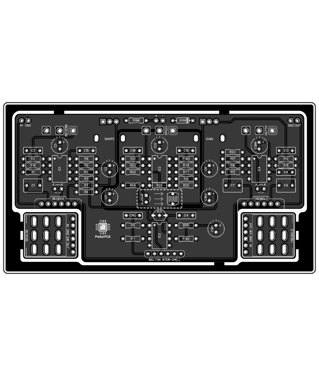

I'd love to see this as well. I can see the BOM, but don't know where each resistor / capacitor is supposed to go. I've seen other threads that say "swap R8 with a 10K for more reverb", but I don't know what the current value of R8 should be when buying components.
I just checked my Sproing Deluxe PCB and R8 is 10k; I do not have the regular Sproing PCB, so I can't say what R8 is for that one.
Between the pic below and board-in-hand with values silkscreened on, you're good to go.
I believe it's R8- 39K on the Sproing, 10K on the Deluxe!
The lower you go, The more spacial it gets!
I settled on 25K on my Sproing & it sounds Great!
You could use a Trimit PCB with a 50k Trimmer & you can set where you want
