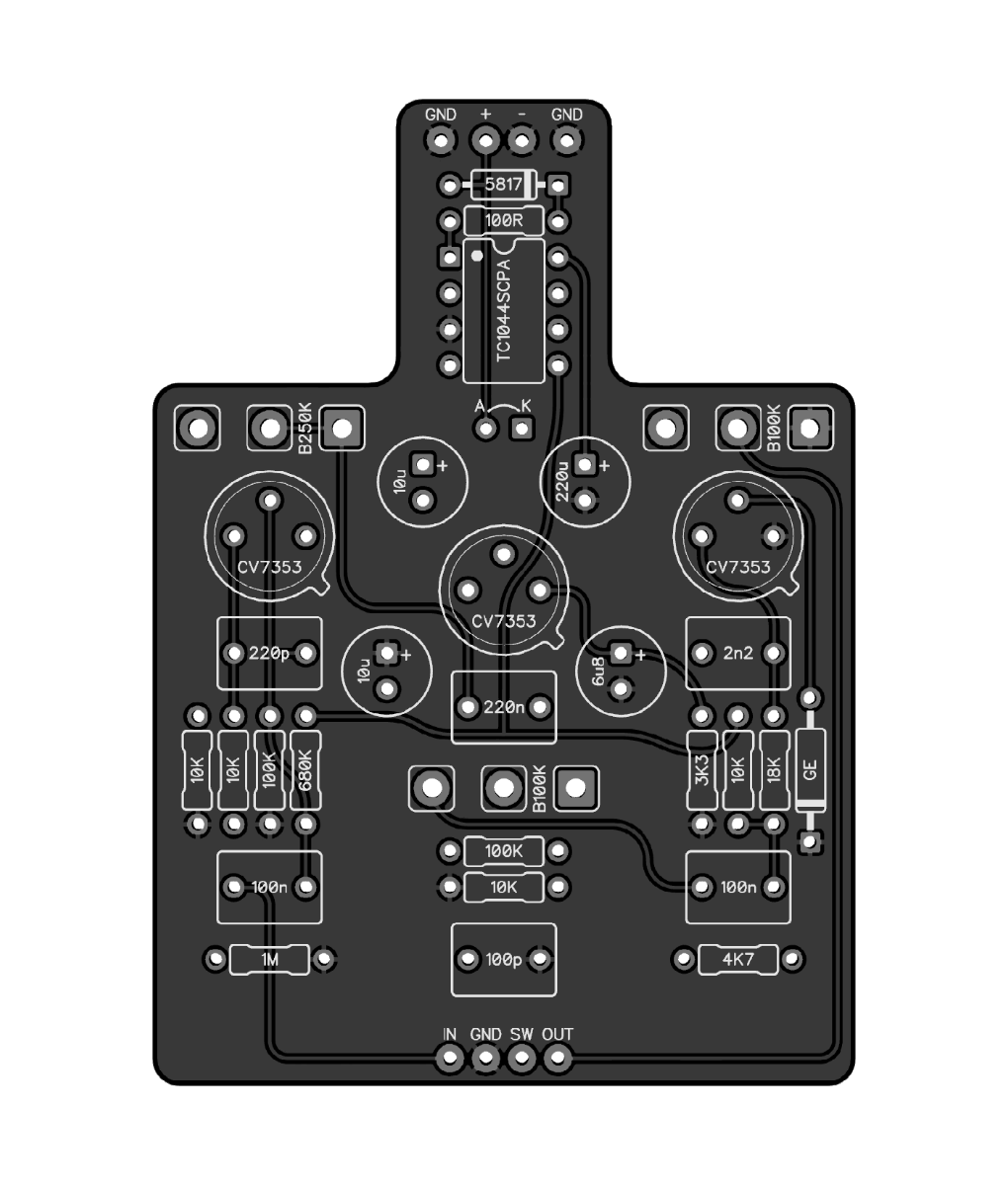

For the Two Tone Fuzz, how far down from the bias and impedance are the two switches? (I'm looking for the measurement so I can get Tayda to drill it, but the PCB is still in the mail at the moment) I have the rest of the drill template set, appear to be a standard 4knob otherwise
This worked fine for me https://drill.taydakits.com/box-designs/new?public_key=d0RidDhadTVnemZrRVBvaEFMOVA4dz09Cg==
It's for an outie DC jack so change it to what suits you, or just copy the switch locations.
Edit: I guess for posterity the Y positions are 38mm, 12.8mm and -8.3mm, so that's the two pots and a switch that are in line vertically. So... 21.1mm? I don't remember how I ended up with that, but like I said, it worked.
