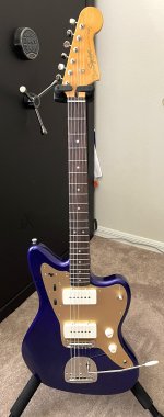

So why did I need this guitar? Well.....because I always wanted a vintage-ish JM.
The only tune I can actually call to mind that uses a jazzmaster is Jeff Skunk Baxter playing the melodic refrain in Steely Dan's "Any Major Dude".
Nevertheless., being the gear slut that I am, I can never pass up a good deal. A number of the Squeir Classic Vibe models have gone on sale recently.
Including this one from Chicago Music Exchange. This is one of the FSR runs they do in conjunction with Andertons in the UK and I've been eyeing it for a quite a while.
So when I got an additional coupon code from Capital One Shopping for CME, PLUS an additional $50 knocked off for a very small finish chip on the back of the guitar I just couldn't resist. I think this came out to be around $330 shipped.
I'm a big fan of the Squeir Classic Vibe line. They are all solid guitars. Well made, and have vintage style appointments and pickups. The vintage style appointments and pickups really is what attracts me the most. I lean that way anyway, and the more modern styled JM's never made a whole lot of sense to me.
Having said that, these guitars typically need some work to get them playing optimally and to my rather picky standards.
Out of the box shot here....sure is pretty! The gold anodized pickguard has an old school 60's JM vibe. (But not the purple....I don't think Fender ever did any purple JMs).
