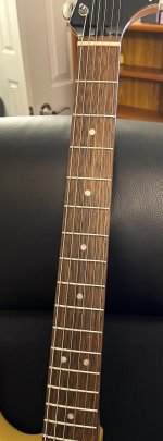

I've mentioned before how much I like Indian Laurel as a fingerboard rosewood substitute. Much better than Pau Ferro.
Laurel feels more like rosewood to me. The FB that came on my guitar was very even grained and already very rosewood looking.
It was playable out of the box, but I still like to smooth it out a bit with a razor blade.
Like my Epiphone ES339 I experimented a bit with darkening the fingerboard.

The stock nut was "graphite". Looks like black plastic to me. I replaced it with a bone nut.
Continued in next post......
After staining the fingerboard and wiping it down, I rubbed in a couple coats of Howards "Feed n Wax".
I've used that stuff on my kitchen cutting boards but never on fingerboards. I LIKE IT! I think I'll be using it more often.
It buffs to a really nice sheen and feels great!
